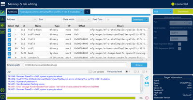

fsbl1 (0x4): invalid address 0x4400 (min=0x80000) on loading flash layout image for eMMC
2024-06-14 2:15 AM
Dear All,
I have been trying to burn eMMC by CubeProgrammer.
Unfortunately I encounter Error: fsbl1 (0x4):invalid address 0x4400(min=0x80000)
This is my layout information in tsv file.
#Opt Id Name Type IP Offset Binary
- 0x01 fsbl1-boot Binary none 0x0 mfgimages/tf-a-stm32mp15xc-ya151c-512d-t-serialboot.stm32
- 0x03 ssbl-boot Binary none 0x0 mfgimages/u-boot-stm32mp15xc-ya151c-512d-t-trusted.stm32
P 0x04 fsbl1 Binary mmc1 0x00004400 mfgimages/tf-a-stm32mp15xc-ya151c-512d-t-trusted.stm32
P 0x05 fsbl2 Binary mmc1 0x00044400 mfgimages/tf-a-stm32mp15xc-ya151c-512d-t-trusted.stm32
PD 0x06 ssbl Binary mmc1 0x00084400 mfgimages/u-boot-stm32mp15xc-ya151c-512d-t-trusted.stm32
P 0x21 boot System mmc1 0x00284400 mfgimages/st-image-bootfs-openstlinux-eglfs-myir-ya151c-t.ext4
P 0x22 vendorfs FileSystem mmc1 0x04284400 mfgimages/st-image-vendorfs-openstlinux-eglfs-myir-ya151c-t.ext4
P 0x23 rootfs FileSystem mmc1 0x05284400 mfgimages/myir-image-core-openstlinux-eglfs-myir-ya151c-t.ext4
P 0x24 userfs FileSystem mmc1 0x85284400 mfgimages/st-image-userfs-openstlinux-eglfs-myir-ya151c-t.ext4
What shall I need to do fixing this problem?
Regards,
KIM

This is captured image on error.
