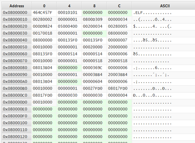

I'm having the same issue identified in the following post in the latest (as of now) version of STM32CubeProgrammer: https://community.st.com/t5/stm32cubeprogrammer-mcus/flashing-elf-with-stm32cubeprogrammer-flashes-garbage-before/td-p/154225
Can that discussion be re-opened or an update provided here?

Not actually garbage, but .ELF header data, not sure if it keys on extension, case, or magic patterns..

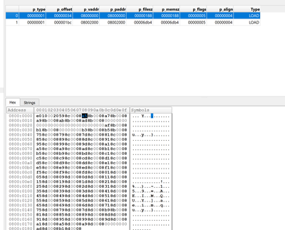

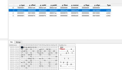

Hello @Jon Enz ,
For now, I can't reproduce the issue you're seeing with .elf files generated by CubeIDE or EWARM. When relocating an application for an STM32L476 for example, there is a segment in the beginning of the flash, however, this segment has nothing to do with .ELF overhead. I suspect it has to do with jumping to the main application, since removing it will prevent the relocated app from running properly.
As for this thread : https://community.st.com/t5/stm32cubeprogrammer-mcus/flashing-elf-with-stm32cubeprogrammer-flashes-garbage-before/td-p/154225. What I noticed when opening the attachment by @Rami Rosenbaum(using multiple elf parsers/viewers) is that the elf extension overhead is indeed pointed to by a load type segment in the program/segment headers.
That's the part interpreted by CubeProgrammer (and several other tools), and usually that's not the case in elf files, here's an example elf compiled with EWARM (with a relocated app).
So as stated by @Pavel A. & @Tesla DeLorean ,we need to know the toolchain you're using in order to investigate further. Attaching the .ELF file could also be helpful.

The toolchain used to generate the file was ARM GNU 10-2020-q4-major. I can confirm that loading the .hex file shows the data starting at the correct location.
Unfortunately I cannot share the project files directly, but I was able to create a reduced project that produces the same result. The .elf and .hex files are in the build directory of the attached file. You can re-run the build using the following commands.
Configure:
cmake -B build -DCMAKE_TOOLCHAIN_FILE=toolchain-embedded-arm.cmake -G "MinGW Makefiles" -DCMAKE_BUILD_TYPE:STRING=Debug
Build:
cmake --build build --target ELF-TEST.elf
