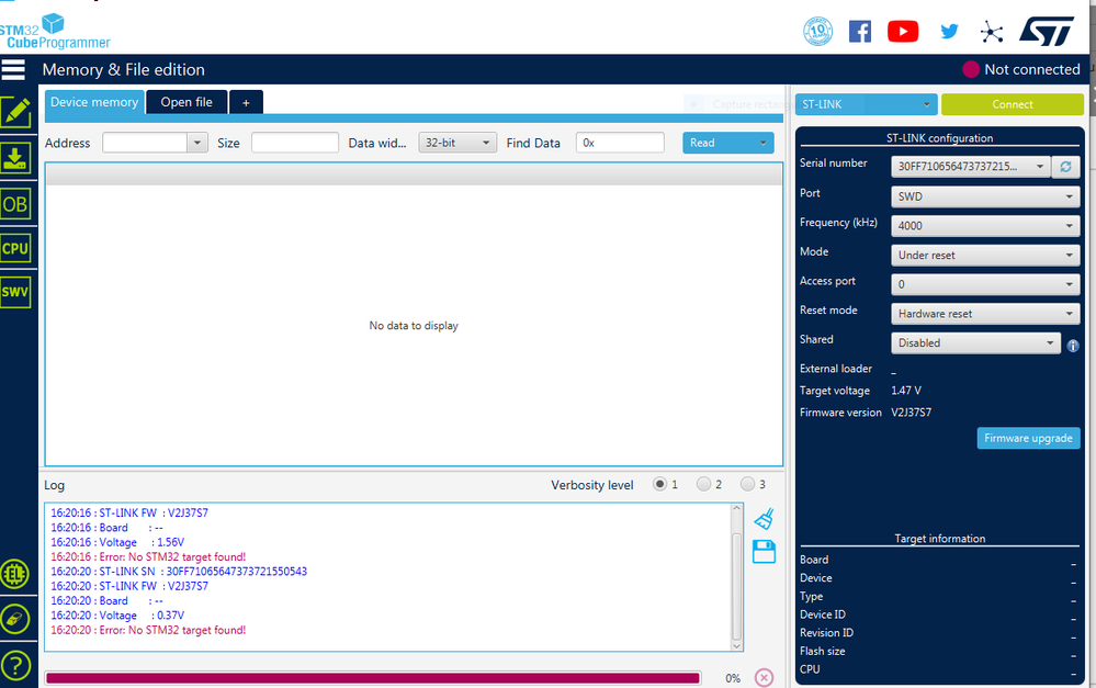

Hi all,
I've bought this board https://wiki.seeedstudio.com/LoRa_E5_Dev_Board/ and for now I try to create my own program with stmSDK. But I hae an error when I try to erase AT firmware give by Seed. I've connect my ST-LINK/V2 to the board like it said in the wiki with SWD. But when I run STM32CubeProgrammer I encoutering an error `No STM32 target found!`. Before clicked in connect button I hold reset button on the board. I've upgraded my st-link/v2 firmware
I've followed this procedure https://wiki.seeedstudio.com/LoRa_E5_Dev_Board/#2-develop-with-stm32cube-mcu-package

‎2021-12-17 5:43 AM
Check cabling, check power.
‎2022-07-27 3:05 AM
Hold a RST button while you click a connect button on STM32CubeProgrammer.
