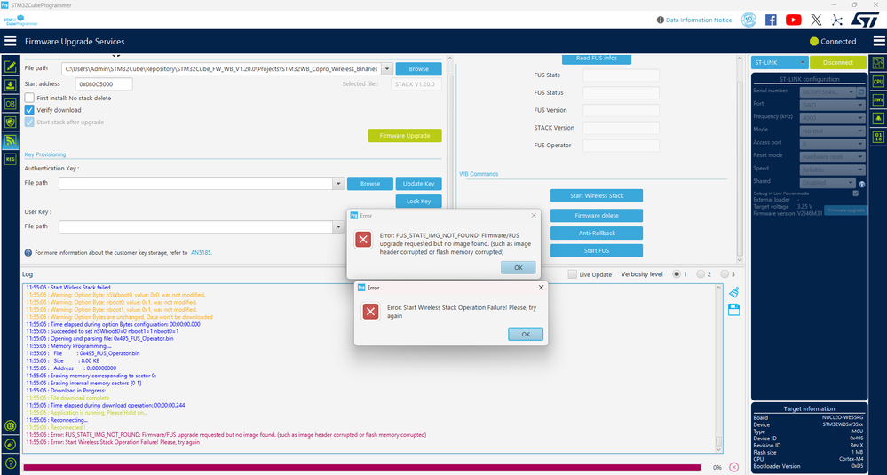

    I am using NUCLEO-WB55RG board to implement BLE and I got error when I was Upgrading my STACK Version currently which is v0.0.0.0 in STM32CubeProgrammers FIRMWARE UPGRADE SERVICE option, I select stm32wb5x_BLE_Stack_full_fw.bin with 0x080D4000 memory location for stack upgrade which is preferred by STMicroelectronics official documentation, I have post my Screenshot after multiple attempts no update in STACK Version.
--> It is mandatory to upgrade STACK Version for implement BLE?
--> Also want better suggestion & Guidance Documents for BLE implement from basic to advance?
it would be grateful for any guidance!...

             Thank you @Aziz BRIGUI, Now I am Facing another issue, I am not able to Start Wireless Stack in FUS, So my question is How can I enable or start Wireless Stack which run Stack which I upload on Nucleo-WB55RG development board with STM32WB55RGV6 microcontroller, My another question is If wireless stack is running on my microcontroller how can I confirm that Wireless stack is running is there any flag or any command for it? I have attached screenshot for your reference.
After click on Start Wireless Stack, Error pop up windows appeared on my screen how can I solve this issue?
After click on Start Wireless Stack I got Above Error Popups.After click on Start Wireless Stack I got Above Error Popups.
