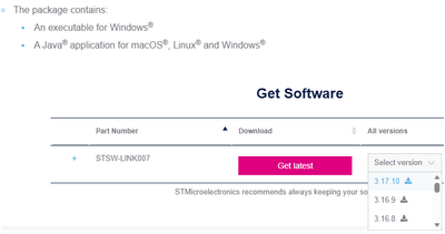

Pavel A.
Check the USB cable.
Do the update on a decent Windows PC. If nothing of the ST software is installed on the Windows PC, get the small  standalone updater: https://www.st.com/en/development-tools/stsw-link007.html

UFo
Surprisingly, the Upgrade worked under Windows.
Thanks a lot.
