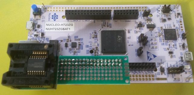

As I've offered before​, I can help the team with beta and QA testing this stuff, as I have a background in ELF and object loaders, and mass storage devices. I also have a lot of STM32 systems fixtured to take an assortment of QSPI flash chips.
‎2021-09-01 2:04 AM
The main external loader repository is here https://github.com/cturvey/stm32extldr
Supporting a lot of chip and pin combinations, both those encountered, and built to order as needed.
