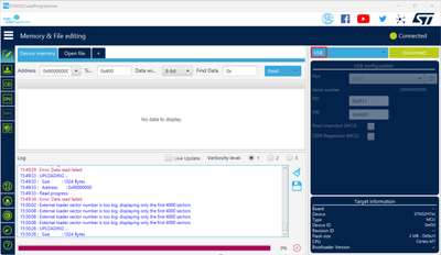

If I use CubeProgrammer to connect the internal boot loader of STM32H750XBH6 via USB (pull Boot-0 high), can I program the external SPI Flash through CubeProgrammer? I know it's possible to do this using ST-Link (ps. by stldr) directly, but I can't do it using USB by similiar way.

This use case is not supported with the STM32 internal bootloader, so I suggest developing your custom USB bootloader to support the SPI flash. You can refer to AN3156 and the open bootloader middleware for guidance.

But in lieu of an external loader you could implement a USB-DFU device capable of describing all the memories in the system and facilitating the use of STM32 Cube Programmer.
The alternative on say a H750 with limited internal Flash is to be a USB-MSC and allow for drag-n-drop, there should be code from Microsoft and Arduino implementing such methods as UF2 or whatever. I've build things where QSPI, or a portion, is used as a direct MSC volume, the loader can then recover files by name to perform updates into the active / code portion of the QSPI
