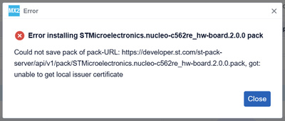

wanted to check if C5 might be good for next project and have a first look at MX2.
Installed it, started project with C562 / Nucleo - and nothing happens, except for a short error message in the bottom right corner of the window: "error when downloading packs" ( + some file name).

Tried to install now via the "Pack manager", now some more error info:
Oussama_TROUDI
Hi @LCE,
it looks like STM32CubeMX2 cannot validate the HTTPS certificate when downloading packs from
https://developer.st.com/st-pack-server/ ....
This is typically related to network / proxy / corporate security settings:

Hi @LCE
Thanks for this clarification

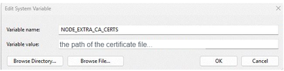

In this case, what you need is to configure a proxy or a certificate to be able to access the servers and download packages.
  • Get your certificate from your company IT or company portal.
  • Place it under C:\certificate, for example.
  • Add the Windows environment variable NODE_EXTRA_CA_CERTS with the path to this certificate file. (Make sure that the path has no quotes.)
  • Finally, restart STM32CubeMX2.
You can also refer to this article for more details on: How to configure the proxy or certificate
