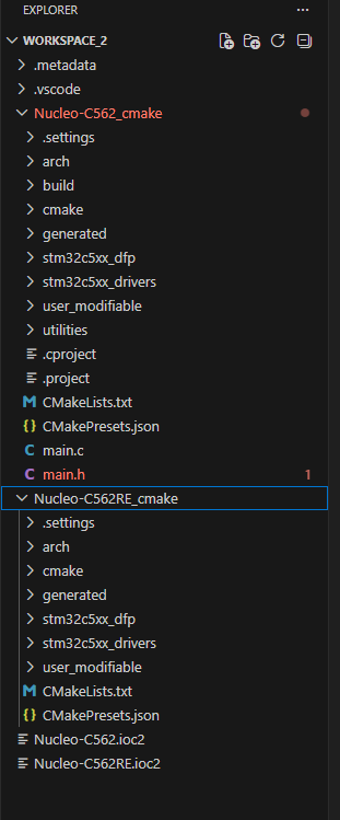

Yesterday I was able to generate a cmake project which included main.c/h files. I opened the project in VS Code but had errors trying to build. I had VS code fix the errors so now I am able to build the project.
  • Today, I generated another project but the main.c/h files are missing as seen in the screen shot.
  • I've timed the project generation and it takes 3 minutes to generate a project. Why so long?
  • Why are the IOC files created outside of the project folder?

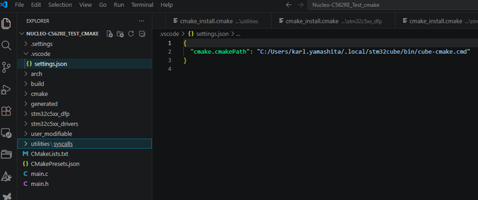

I checked the path and it was set for "cmake" instead of "cube-cmake", so updated it.
When building the project i got different errors
[cmakeExecutable] CMake executable not found in cache. Checking again.
[proc] Executing command: cube-cmake --version
[proc] The command: cube-cmake --version failed with error: Error: spawn cube-cmake ENOENT
[proc] Executing command: cube-cmake -E capabilities
[proc] The command: cube-cmake -E capabilities failed with error: Error: spawn cube-cmake ENOENT
[main] Building folder: Nucleo-C562RE_Test_cmake
[rollbar] Unhandled exception: Unhandled Promise rejection: build Error: Build failed: Unable to configure the project {}
I had the VS Code agent fix it. It added a wrapper "cube-cmake.cmd" which created this text
@Echo off
"%~dp0cube.exe" cmake %*
But it still had the same build error. Then I had the agent try to fix again and it create a settings.json file and added a path.
So now I am able to build the project with zero errors.

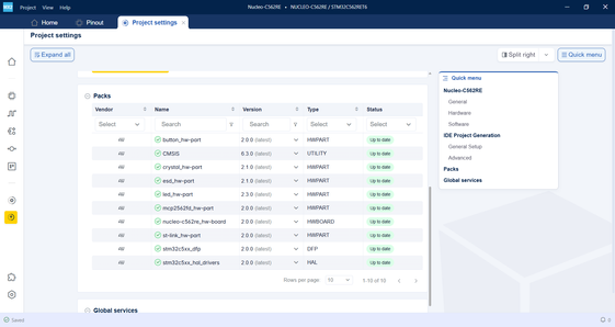

It looks like main.c/h are missing because the pack 'stm32cubemx2_templates_no_os_stm32c5' is not installed in the Pack Manager.
and in the attached project, I didn't see the 'stm32cubemx2_templates_no_os_stm32c5' pack which is responsible of generating those files and the startup component.
It contains only 10 packs while a project created from  board contains 12 packs.Screenshot 2026-03-20 025236.png
we need to check whether the template pack is already installed 'up to date" in Pack Manager.
Could you please open pack manager and share a screenshot of the "Up To date" packs?
Yes, I looked at the project and only 10 packs are there for that project.
The 1st project i created has 12 packs. That project had errors building in VS Code. I had VS code fix it so it would build. I can't remember what it did.
The 2nd project is the one I attached prior that has the missing main.c/h.
