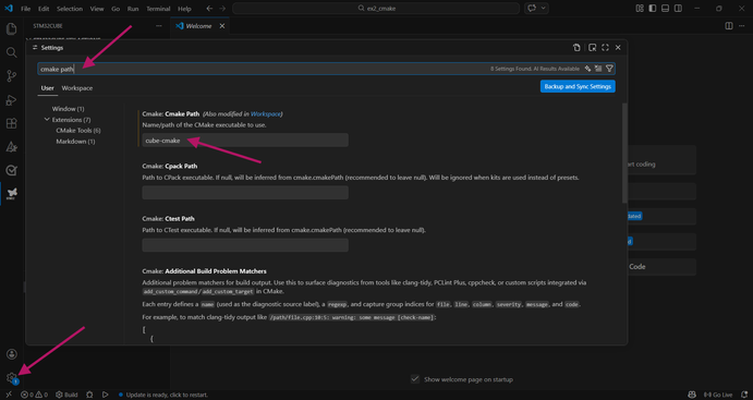

Hi @Karl Yamashita
Yes, for the Cube bundle, all bundles are now up to date.
What you need to do is check the CMake path in the VS Code settings and set it to "cube-cmake" as shown:
I checked the path and it was set for "cmake" instead of "cube-cmake", so updated it.
When building the project i got different errors
[cmakeExecutable] CMake executable not found in cache. Checking again.
[proc] Executing command: cube-cmake --version
[proc] The command: cube-cmake --version failed with error: Error: spawn cube-cmake ENOENT
[proc] Executing command: cube-cmake -E capabilities
[proc] The command: cube-cmake -E capabilities failed with error: Error: spawn cube-cmake ENOENT
[main] Building folder: Nucleo-C562RE_Test_cmake
[rollbar] Unhandled exception: Unhandled Promise rejection: build Error: Build failed: Unable to configure the project {}
I had the VS Code agent fix it. It added a wrapper "cube-cmake.cmd" which created this text
@Echo off
"%~dp0cube.exe" cmake %*
But it still had the same build error. Then I had the agent try to fix again and it create a settings.json file and added a path.
So now I am able to build the project with zero errors.
