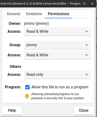

I tried to install the STM32CubeMX2 on Linux Lite 6.6 which is base on Ubuntu 22.04, but get unsupport file error.
I double check that I allow this file to run as a program.
Is there any guide on how to install it on Linux?
Thank you.

This installer is intended to run as a manually started user application, not a package to be installed by apt.
You would just need to run "./stm32cube...Linux-installer" from the commandline.

Hi Ozone,
Your suggestion is right.
At first, I've got error say that can't open file libwebkit2gtk-4.1.
After install this lib, I now can install the STM32CubeMX2.
Thank you.
