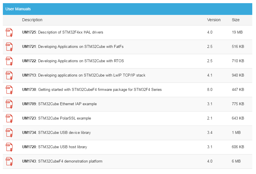

'Lacking documentation': with any HAL firmware package a set of user manuals isprovided
to give adetailed description of each peripheral driver .
Could you please give to us example of missing information on HAL documentation, this may help usto understand well your expectation ?
Itis always required to review errata sheet, datasheet and reference manual in order touse efficiently your device.

My latest problem relates to setting up the Timer peripheral on my STM32F767ZI device. I wanted to use the HAL, so I downloaded the following HAL documentation for the STM32F7xx family:
http://www.st.com/content/ccc/resource/technical/document/user_manual/45/27/9c/32/76/57/48/b9/DM001897pdf/files/DM001897pdf/jcr:content/translations/en.DM001897pdf
Chapter 60 is about the 'HAL TIM Generic Driver'. It basically lists out all the HAL functions and structures, but it doesn't explain how the Timer peripheral works. There is only one page (p 890) explaining very short 'How to use this driver'. But that is definitely not enough to start using it.
So I fall back on the STM32f7xx Reference Manual:
http://www.st.com/content/ccc/resource/technical/document/reference_manual/group0/96/8b/0d/ec/16/22/43/71/DM00224583/files/DM002245pdf/jcr:content/translations/en.DM002245pdf
The reference manual is very well written. It explains the timer module in very deep detail. After reading the reference manual, I can dig into the HAL code myself and reverse-engineer how it works.I have no issue with this personally - I like understanding how things work down to the bottom.
However, my employer hoped that the ST HAL would enable me to put the big Reference Manual aside and get things done quicker thanks to the HAL abstractions. But I miss the docs..
After reading your answer, I realized I didn't check all the application notes. I just found out the existence of the following document:
http://www.st.com/content/ccc/resource/technical/document/application_note/group0/91/01/84/3f/7c/67/41/3f/DM00236305/files/DM00236pdf/jcr:content/translations/en.DM00236pdf
This application note is quite big - 73 pages. I scroll through it now to get a feeling of what sort of information it contains. It refers indeed to the HAL, but most of its explanations are also on the register-level (see page 30, 31, 36, 37, ...). Perhaps it can be compared somewhat to the Reference Manual?
