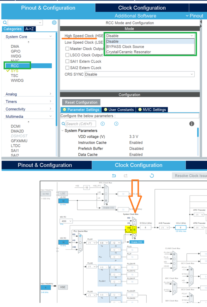

Why I could not configure HSE by Clock Configuration of CubeMX 5.3.0?
VKole
CubeMX ver. 5.3.0. I tried different microcontrollers.
Khouloud ZEMMELI
​Hello @VKole​ ,
First you need to enable RCC in HSE mode then you can use it under Clock config.
