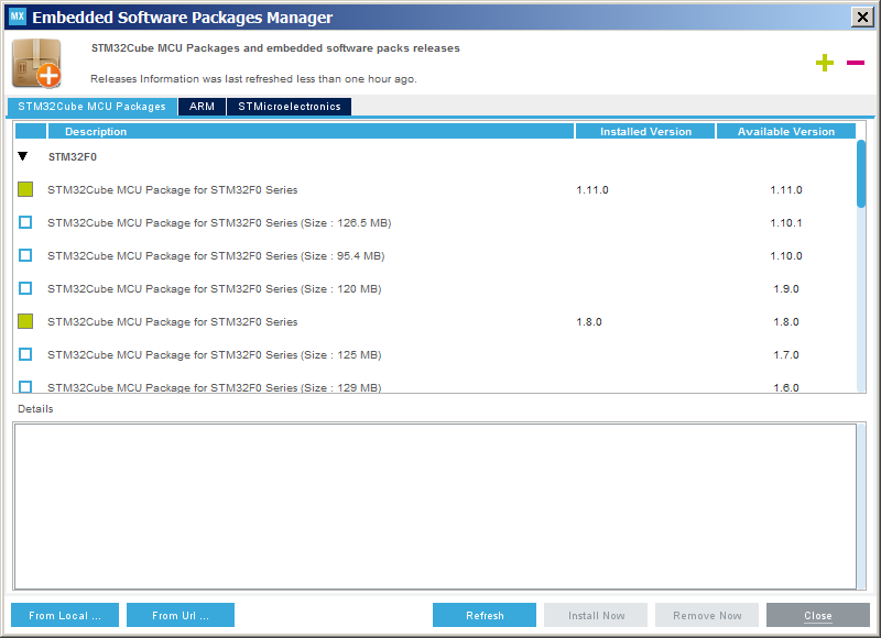

Hi everyone,
I created this small project.
I uploaded package firmware to version 1.11.0
When I generate the code I have all these error messages.
The only one we don't need to pay attention is the first error as it's a lib I imported myself.
But why I have missing files even if last updated drivers?
Let me know if you need to know something else in order to help me. Thank you

Hello @Community member​
You are using an old firmware package. (STM32Cube FW_F0 V1.8.0)
Try to use STM32Cube_FW_F0_V1.11.0, it works correctly. (there is no error messages)
Best regards,
Nesrine
‎2020-05-11 2:17 AM
OK Thank you, I don't understand why I didn't select the newer version but that's fine, let's move on
