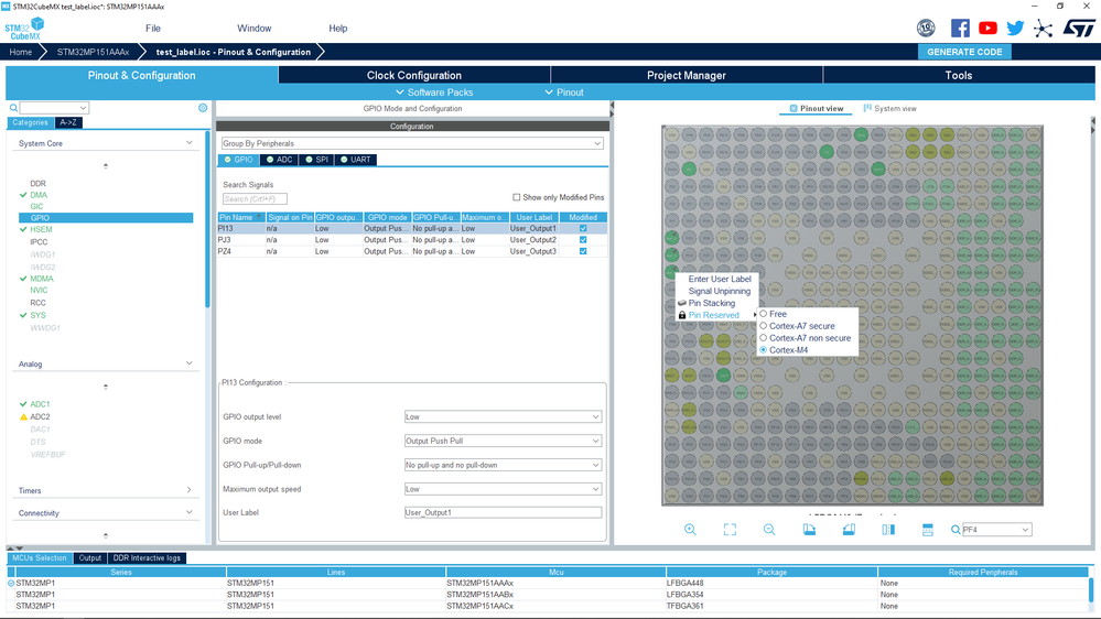

What is the purpose of labeling pins in the MX program if you cannot use the labels in your code?
KiptonM
Lead
In the Device Configuration Tool it allows you to name pins. But it appears my program is not aware of those pin names and I cannot find any .h or .c file where the mapping is defined. The are only defined in a .ioc file, which the compiler does not use.
I would have thought the Code Generator would have done that.
So I have to make my own .h file with the mapping defined.

Hello @KiptonM​ ,
Thanks for your feedback,
Seems that you didn't assign the pins to Cortex M4, to do so you need to right click on the pin and then select Cortex M4 which is under Pin Reserved field (Please refer to the attachement).
Please try to test it and if it didn't work then please share your .ioc file and specify the CubeMX version.

Bob S
When you say "name pins", do you mean that you enter something in the "User Label" field? If so, those DO show up in the code, see main.h. For example, is you name a pin "BLUE_LED", you will find #defines for BLUE_LED_GPIO_Port and BLUE_LED_Pin. Those defines can then be used in HAL_GPIO_WritePin(), etc., or the HAL_LL_GPIO functions, or even in your own "write direct to registers" code.
Or are you somehow doing something else to "name" the pins?

I do not know what you are talking about.
Here is my entire generated main.h file

Here is a screen shot of some of my GPIO pins from MX
KiptonM
Lead
Cut and paste did not work. Here is the screen shot.
For MCUs, the labels are defined in main.h (and only for the core they're assigned to, for multi-core chips).
You're on an MPU and the usage may be different.
I updated the topic tag from MCUs to MPUs.

Sara BEN HADJ YAHYA
Hello @KiptonM​ ,

KiptonM
Lead
I did not know that existed. On other pins it is in the configuration window where you choose which processor it is.
The IDE is very good at hiding options.
Thanks,
Kip
Hello @KiptonM​ ,
You are right, with other multicore MCUs, CubeMX let the user choose the pin context, but with the MP1 family this option is not available yet. This is a known issue and already reported internally. It will be fixed soon.
