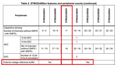

I am using STM32CubeMX in version 6.14.1 with STM32U585OIY6QTR selected.
Trying to Setup VREFBUF Mode I can not set anything since it is greyed out.
VREF should be supported by this MCU.

Indeed and according to the datasheet:
A ticket will be escalated internally (internal ticket number 207882). Thank you for your contribution.
