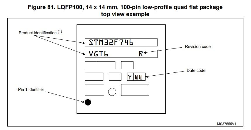

STM32CubeMX and the chip itself seem to have pin 1. marked differently.
I just got 100pin STM32F746vet from Digikey, If I hold it with text correctly there are are two dots or dimples on lewer left corner and upper right corner. But report from Cube has that dot on upper left corner. See the attached pdf.
How can I find the pin 1.

The logo and treatment in CubeMX is NOT reflective of devices and printing.
Here the TOP-LEFT and LOGO are orientated for easy/normal reading in Monkey eXpress

"The logo and treatment in CubeMX is NOT reflective of devices and printing." I wish it would. Now it is misleading.
In what datasheet orientation is clearly explained then. Or atleast explained.

The part's data sheet, search on "marking"
