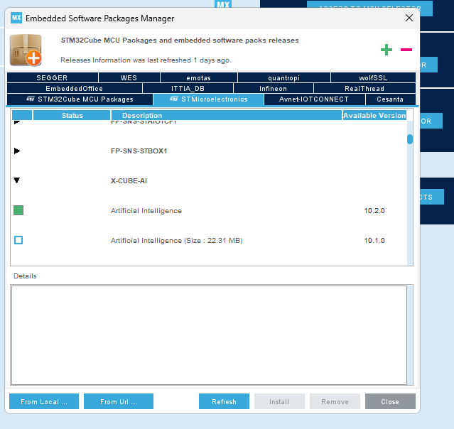

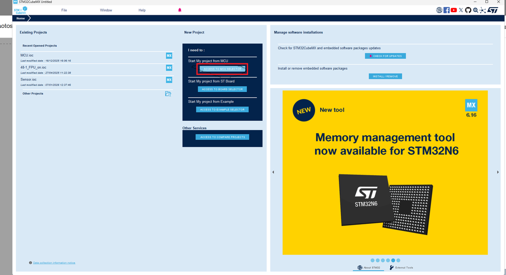

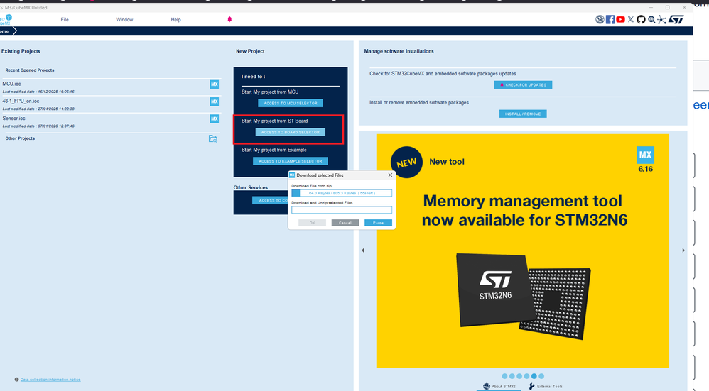

The MCU selector cannot be opened, but the board selector can be opened normally.
jungle_bert
When I clicked the "Access to MCU Selector" button, the interface did not respond. The pointer just kept rotating to indicate loading. However, when I clicked the "Access to Board Selector" button at this time, the selection interface could be opened.
On the board selection interface, when I clicked the MCU/MPU Selector interface, it still showed the situation where the pointer was rotating and indicating a loading process, and I did not enter the MCU selection interface.

Hello @jungle_bert
Go to Help → Manage embedded software packages and:
Re‑download and install  the AI.
In case of an issue, please provide a screenshot of the steps that you followed.
I will be waiting for your feedback.
THX
Ghofrane
Is this the package you want? But after I unzipped this bag, I was unable to open the MCU selector.
