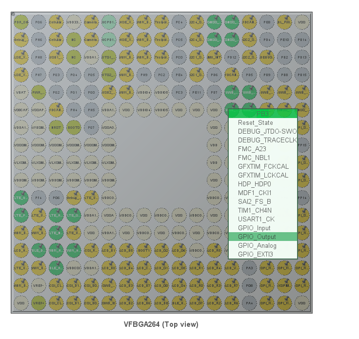

Hello Team,
We are developing a custom board based on the STM32N657 MCU. During pin assignment in the CubeMX tool, PB3 is shown with the JTDO_SWO function. However, the datasheet indicates that the SWO functionality is associated with PB5.
Could you please confirm which pin actually supports the SWO function?

If you click on PB5 will you see SWO there?

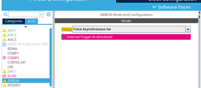

you did/have to choose in Cube   :
..then the needed pins swd, sdc, swo are set/used for this.

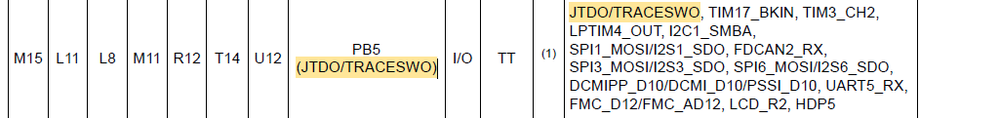

But from ds it is PB5 on N657.
If wrong pin is set by Cube ...found a bug.

The correct SWO (Serial Wire Output) pin on the STM32N657 is PB5. [1, 2]
The behavior you are seeing is a known bug in STM32CubeMX. The tool incorrectly defaults to assigning the SWO functionality to PB3. However, on the STM32N6, PB3 is reserved for the trace clock (TRACECLK), and measuring it with an oscilloscope will show that it remains inactive. [1, 2, 3]
If you are laying out a custom PCB or connecting an external ST-LINK, ensure you route the trace directly to PB5. [1, 2]

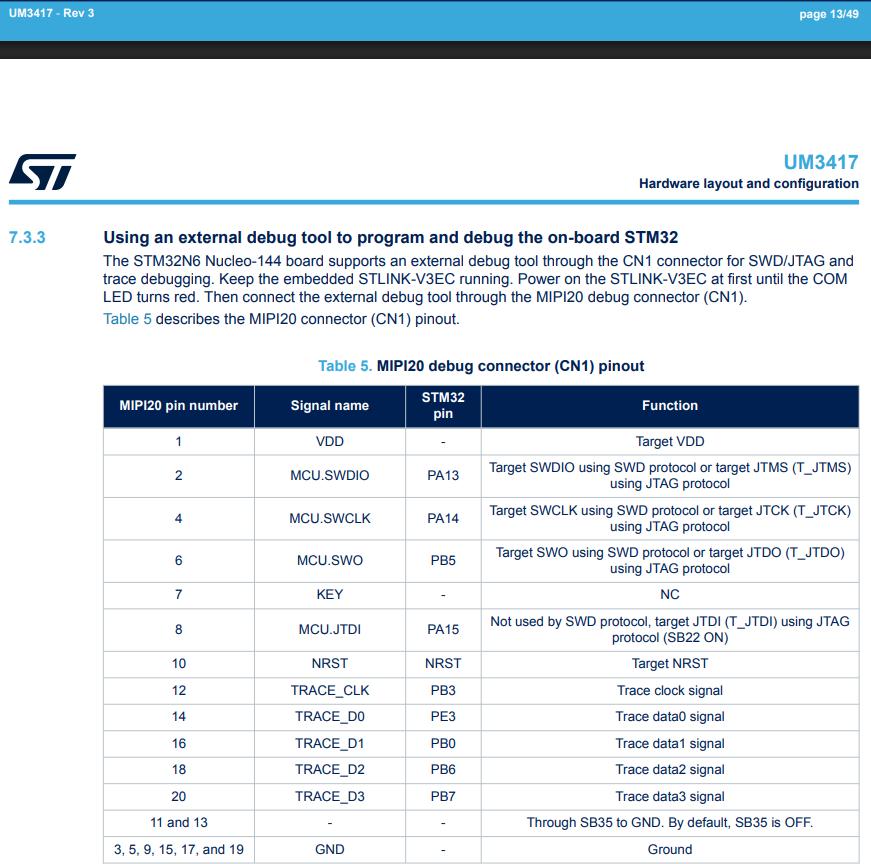

Andrew Neil
The User Manual for the NUCLEO-N657X0-Q (MB1940) shows SWO as PB5:
via: https://www.st.com/en/evaluation-tools/nucleo-n657x0-q.html#documentation
