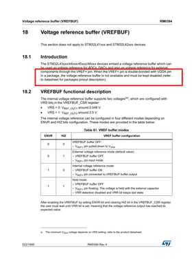

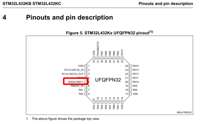

Why isn't VREFBUF enable available in CubeMX for the STM32L432 series? I believe the reference manual says this series has control over the VREFBUF. It also seems there's no struct for VREFBUF control in the stm32l432xx.h file.

VREFBUF in STM32L432KC is not available, as VREF+ is bonded to VDDA in that chip.
