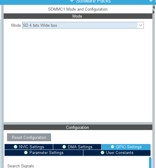

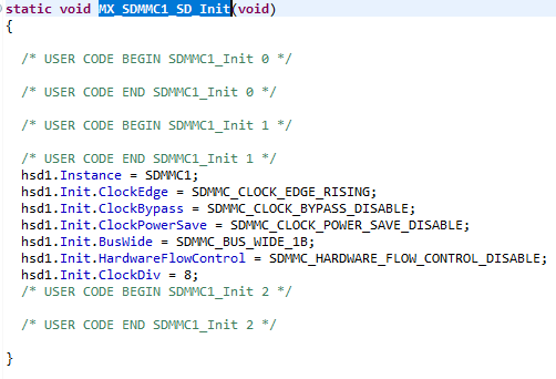

0693W000006FFWVQA4.png0693W000006FFWfQAO.pngHello, I'm using an stm32l496rgt (64 pins).
When I set SD 4 bits wide bus on SDMMC I noted that the code created set SDMMC_BUS_WIDE_1B instead of 4B.
In this configuration the sd card doesn't work, it works only with 1 bit bus.
4 bits data bus works properly in stm32l4r5zit6p (144 pins).
Is there a problem on 64 pin version?

Thanks for your reply, you are right, the 4 bit wires where set in BSP_SD_Init.
But we have found problems using dma, solved with the help of this link:

Hi DVacc.1,
Thank you for your feedback. Probably, this is a bug on the IDE. I will look for it internally and respond you soon.

The chip always comes up in 1 bit mode and is switched to 4 bit mode through a later call.
In your linked code, it doesn't even call HAL_SD_Init, so the generated code is missing.
I generated a new project, selected 4 bit SD, and the generated code came out correct:

This has come up before, so there's likely a bug somewhere but I can't reproduce it.
