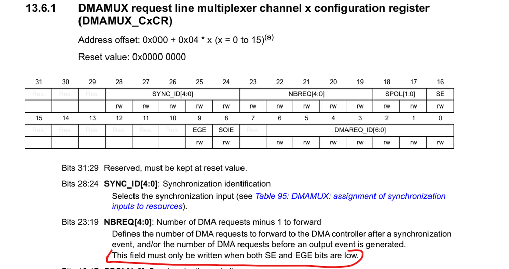

STM32G4 SPI: wrongly set LL_DMAMUX_SetSyncRequestNb after LL_DMAMUX_EnableSync
DR1001
STM32G491
Code generator generate wrong order of calls for SPI initialization for LL driver: LL_DMAMUX_SetSyncRequestNb  calls after LL_DMAMUX_EnableSync

Hello @DR1001
The initialization sequence generated by STM32CubeMX for DMAMUX synchronization is functionally correct and safe. LL_DMAMUX_SetSyncRequestNb() only programs a configuration field and does not rely on synchronization being enabled beforehand. In a typical startup sequence, the DMA channel is not yet active and no meaningful sync events are processed while these registers are being configured, so the exact order of these two calls has no impact on runtime behavior.
According to the documentation:
