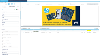

I'm creating a new project for STM32G030F6P6 in STM32CubeMX. It says 32 kBytes flash.

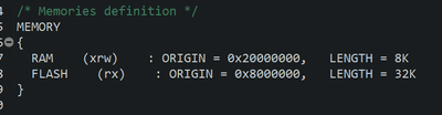

The linker script generated for CubeIDE shows 32kB here. Probably an IAR-specific issue.
‎2023-10-16 7:18 AM
Yes. if I generate an STM32CubeIDE project the STM32G030F6PX_FLASH.ld is correct. But when I select EWARM project the stm32g030xx_flash.icf is incorrect.
I hope ST fixes this. This could suddenly break firmware.
