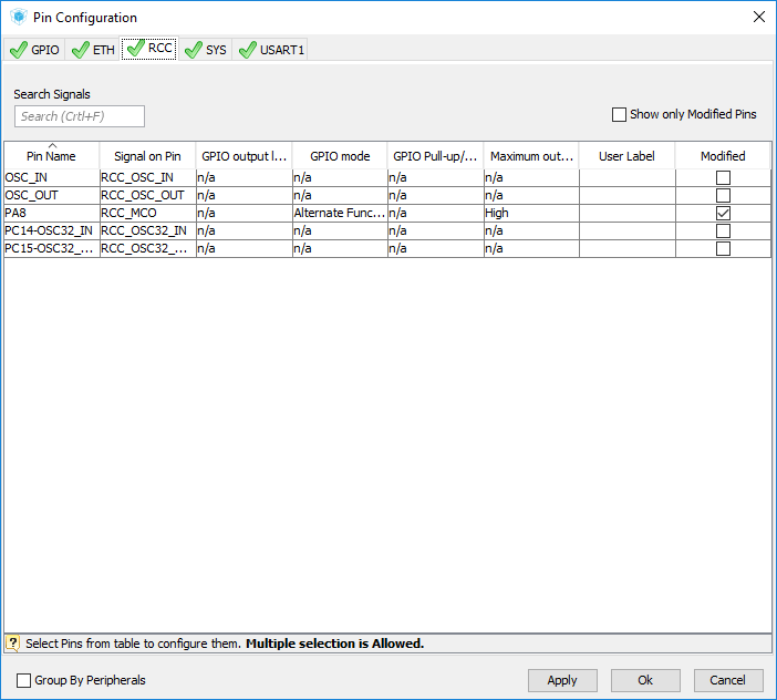

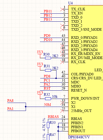

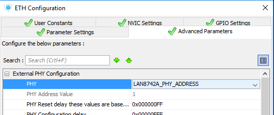

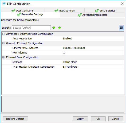

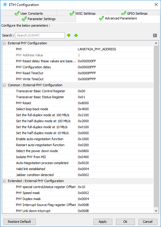

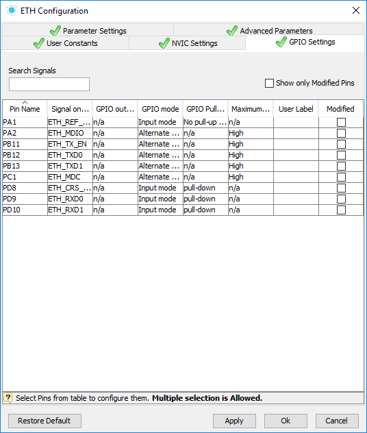

Hello
I want config STM32F107vct6 in cubemx to use RMII+DP83848+LWIP without oscilator(I connect PA1 and PA8 to X1)
but in STM32CubeMX->Configuration->ETH->External PHY configuration->PHY is  LAN8742A_PHY_ADDRESS and can not find DP83848
If i must define User PHY , how do it?
My DP83848
My Config
