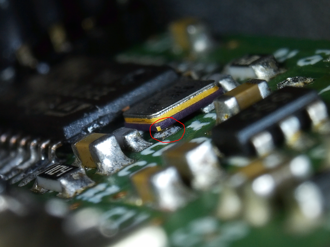

I see that your oscillator is 16MHz but the value in the clock configuration is 8MHz:
See HSE_VALUE macro.
Posted on May 16, 2018 at 13:54
In fact a negligent mistake from me.
I tested momentarily with an 8MHz crystal to see if there were any changes.
When I put the 16MHz crystal back on again, I did not see it oscillates.
Now when I read the post I went to see and itnot
oscillate
... because the crystal was badly welded.
https://s7.postimg.cc/ltkwp7xgr/Capturar.png
Now the crystal is oscillating again.
But it still does not detect anything on the USB ....
