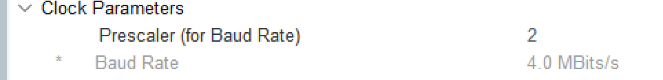

- I see one of them registered already: https://community.st.com/s/question/0D53W000016mim9SAA/is-there-a-way-to-configure-the-order-of-the-auto-generated-code (the same is for SPI initialization).
- STM32CubeMX 6.3.0, MCU STM32F103C8Tx: Connectivity / SPI1 / Mode: Full-duplex Slave, there is Prescaler and Baud Rate configuration in Parameter settings, which is useless for slave mode.

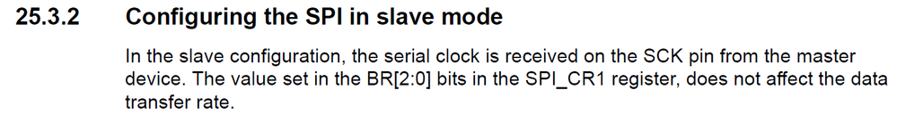

In slave mode, the prescaler configures the maximum supported clock rate. Only the prescaler is editable, the baud rate is informational.
‎2021-10-04 7:44 AM
Thank you, TDK.
Yes, Baud Rate is non-editable.

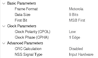

- Where is it described (In slave mode, the prescaler configures the maximum supported clock rate)? (My colleague said that in corresponding HAL sources these configs are ignored in slave mode.)
- Why there is no such Prescaler configuration for STM32F407VGTx Full-duplex slave mode?
‎2021-10-04 8:03 AM
Hmm, it looks like I'm just wrong here. I'm not sure why I thought that. In both RMs, the prescaler field (BR) in SPIx_CR1 is ignored. Apologies for the noise.

Hello @ADr.1​ , @TDK​ ,
Thanks for your feedbacks.
Actually you're right, Prescaler (for Baud Rate) (as well as Baud Rate) are not configurable and should not appear in CubeMX interface when using SPI in slave mode.
In fact, the SPI master always controls the bus traffic and provides the clock signal to the dedicated slave through the SCK line.
This is reported internally to be reviewed. I'll keep you posted with the updates.
Internal ticket number: 115095 (This is an internal tracking number and is not accessible or usable by customers).
Sorry for any inconvenience that this may cause.
Even though this reply doesn’t directly solve the issue, I’m marking it as Best, since it will help clarify the current situation for other customers with the same question. I will post an update here once the issue has been fixed.
