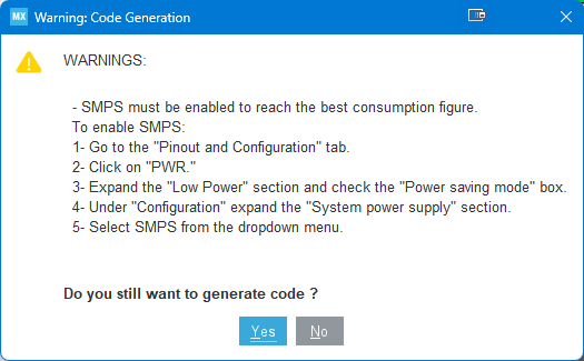

Hello, I have a question about STM32CubeMX regarding the STM32U5G7VJT6 MCU.
STM32CubeMX 6/17.0 indicates that a non-existent SMPS power supply must be enabled for the STM32U5G7VJT6.
However, this is the version without the 'Q' specified in the part number:
Q = Dedicated pinout supporting SMPS step-down converter.
When I call SystemPower_Config(), the microcontroller does not work; without calling this function, it works fine.
Is this a bug in the STM32CubeMX, assuming only Q versions of this MCU exist?
Best regards, Jack
Hello @Jack3
The issue has been submitted to the dedicated team under this internal ticket (Ticket Number: Ticket 228101).
I will let you know when the issue is solved.
Thanks.
Mahmoud

Hello
Let me thank you for posting.
I am currently checking this behavior, and I will get back to you ASAP.
Thanks.
Mahmoud
