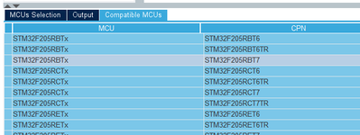

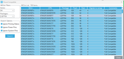

I am running into a similar issue with 6.9.2:
In my case, the button is simply gone to "import"
I do get an extra coloum at the bottom IF I move the bar widths (otherwise it doesnt even show), but I cannot migrate my project to another mcu..
