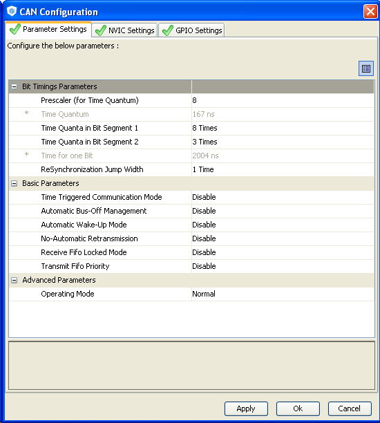

STM32CubeMX 4.6.0
Configurator for
CAN
controller
has
inaccuracy
in
calculating
of time for one bit
If I set
the values for
CAN
speed 500
kbit
/s
bit
time
2000
ns
then
configurator
show 2004
ns.
If

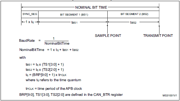

you calculate
the bit
time
from
BS1=8
BS2=3,
prescaler
=8 and APB=48 Mhz, the bit time is
2000
ns
I also recommend
to add to CAN configurator
the calculated
sample
point
It's a very
important value
stm32cubemx-bug-can-bus-bit-time
2 REPLIES 2

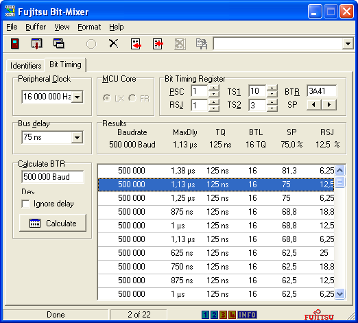

Most controllers configurators show in the table all possible settings.
For example Fujitsu Bitmixer:
If
STM32CubeMX
CAN
configurator
has a different
philosophy
then it would
be useful
show the CAN bus speed,
the sample point
and
indicate
if number of
TQ
8.
