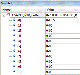

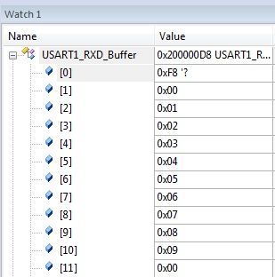

wjandsq
Posted on May 22, 2015 at 07:34
USART2 REMAP have no error, but Receive data number is not correct?
why the first char of receive is always 0xF8 ?
/* USER CODE BEGIN 0 */
#define USART1_RXD_SBUF_MAX 4096
#define USART2_TXD_SBUF_MAX 4096
uint8_t USART1_RXD_Buffer[USART1_RXD_SBUF_MAX];
uint8_t USART2_TXD_Buffer[USART2_TXD_SBUF_MAX];
#define USART1_RX_LEN 11
#define USART2_TX_LEN 10
/* USER CODE END 0 */
  /* USER CODE BEGIN 1 */
  uint16_t i;
  for(i = 0; i < USART2_TX_LEN; ++i)  {
    USART2_TXD_Buffer[i] = i%128;
  /* USER CODE END 1 */
  MX_USART1_UART_Init();
  MX_USART2_UART_Init(); /* F103/429 USARTx_TX Pin have a char,why ?*/
  /* USER CODE BEGIN 2 */
  HAL_GPIO_WritePin(GPIOD,GPIO_PIN_13,GPIO_PIN_SET); // Error
  HAL_GPIO_WritePin(GPIOD,GPIO_PIN_14,GPIO_PIN_SET); // Normal
  HAL_UART_Receive_IT(&huart1, &USART1_RXD_Buffer[0],USART1_RX_LEN);
  HAL_UART_Transmit_IT(&huart2,&USART2_TXD_Buffer[0],USART2_TX_LEN);
  /* USER CODE END 2 */

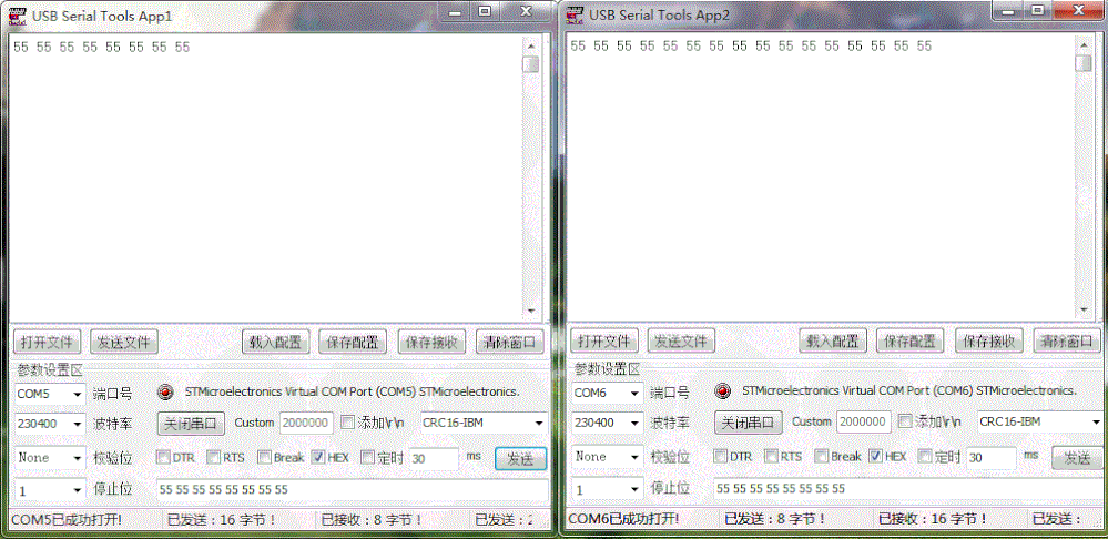

wjandsq
Posted on May 22, 2015 at 08:20
but baud ratechange to 19200 bps, all receive data and number is
correct
when baud rate up to 1000000 bps , into this code and not exit!
Of course, baud rate is 230400bps,hardware have noproblem 。

wjandsq
Posted on May 22, 2015 at 13:40
MX_USART2_UART_Init(); /* USART2 init, but not send */
//HAL_UART_Transmit_IT(&huart2,&USART2_TXD_Buffer[0],USART2_TX_LEN); /* not run ,but still usart1 receive a 0xF8 */

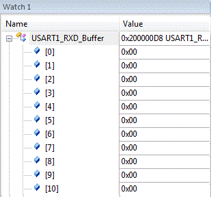

//MX_USART2_UART_Init(); /* off this code, normal */
//HAL_UART_Transmit_IT(&huart2,&USART2_TXD_Buffer[0],USART2_TX_LEN); /* not run */
