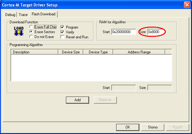

My conditions:
STM32CubeMX 4.7.0
MDK-ARM V5.14
STM32F042F6P6
Generated project for MDK-ARM V5
I
generated a
project for
MDK
ARM
V5
The download
to flash using
the
ST
LINK
was
a mistake
I found a bug
in
setting
of Size
of
RAM
for
Algorithm
STM32CubeMX
set
value
0x8000
but
0x0800
is correct (
MDK
ARM
sets
0x1000 as default
If I generate project for MDK-ARM V4 and migrate to V5, setting is correct.

this issue will be fixed w/ next 4.8 release.
