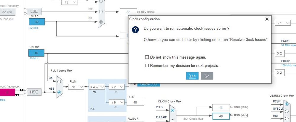

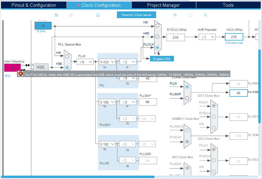

STM32CubeIDE 1.4.2 Device Configuration Tool warns me about HSE value and USB HS when there is only USB FS activated. My ioc file in attachment.

Hello @SPlya.1​ ,
Thank you for your feedback , I will raise this internally to CubeMx team for review.
You can run automatic clock issues solver or click on Resolve Clock Issues to pass over this warning.
Thanks

‎2020-10-08 4:37 AM
Hi @SPlya.1​ ,
Thanks for your contribution and reporting this point.
Issue confirmed and raised to development team to be fixed [ID 94106].
