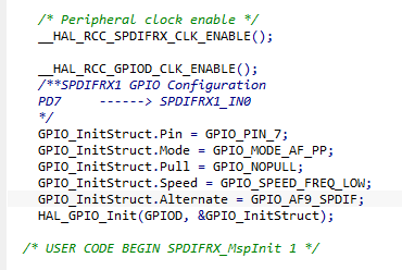

The code generator does not generate this line in hal_msp.c / HAL_SPDIFRX_MspInit()
GPIO_InitStruct.Alternate = GPIO_AF9_SPDIF;
The consequence is that the pin behaves like an output forced to 0 instead of behaving like an input, which obviously prevents SPDIFRX from working.
The problem occurs at least for the 2 first SPDIFRX input lines.

Hello All,
This is a known and old issue with previous CubeMX versions and it's fixed.
@laurentc, please download and use the latest release of STM32CubeMX. which contains enhancement and fix issues.
Thanks
Imen

> STMCubeMx 6.1.2
The current version is 6.10.0. Even if v6.1.2 has bugs, you would need to update the version if they got addressed.
Try it in the latest version. A lot has happened between the two. If the bug is still there, please attach the IOC file that shows the issue.
