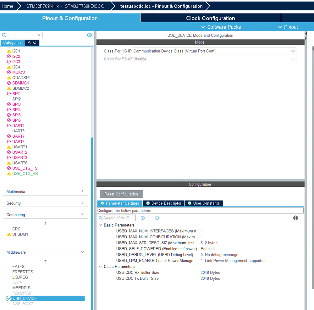

I try to setup CDC USB HS with DMA but it blocks after few samples sent.
Here is the minimal code that replicate the problem

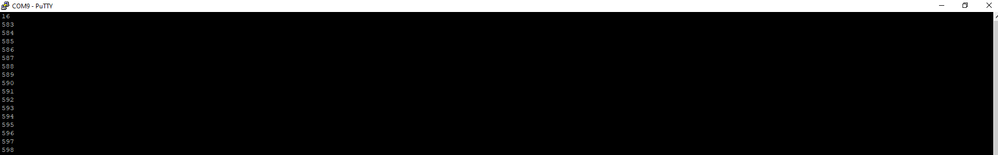

On the host side, I open CDC com port in putty, I begin to receive samples sents by stm32 but immediately after few sample no more lines appears.

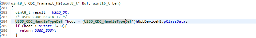

0693W00000UnWhtQAF.pngIt blocks here with USBD_BUSY:

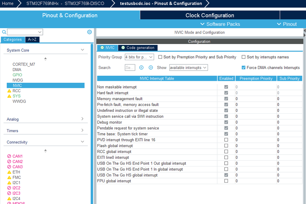

0693W00000UnWjpQAF.pngI use STM32F769I-DISCO board,
STM32CubeMX Version 6.6.1
STM32Cube FW_F7 V1.17.0

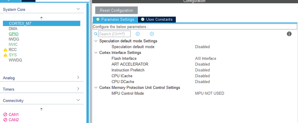

CPU ICache and DCache disabled

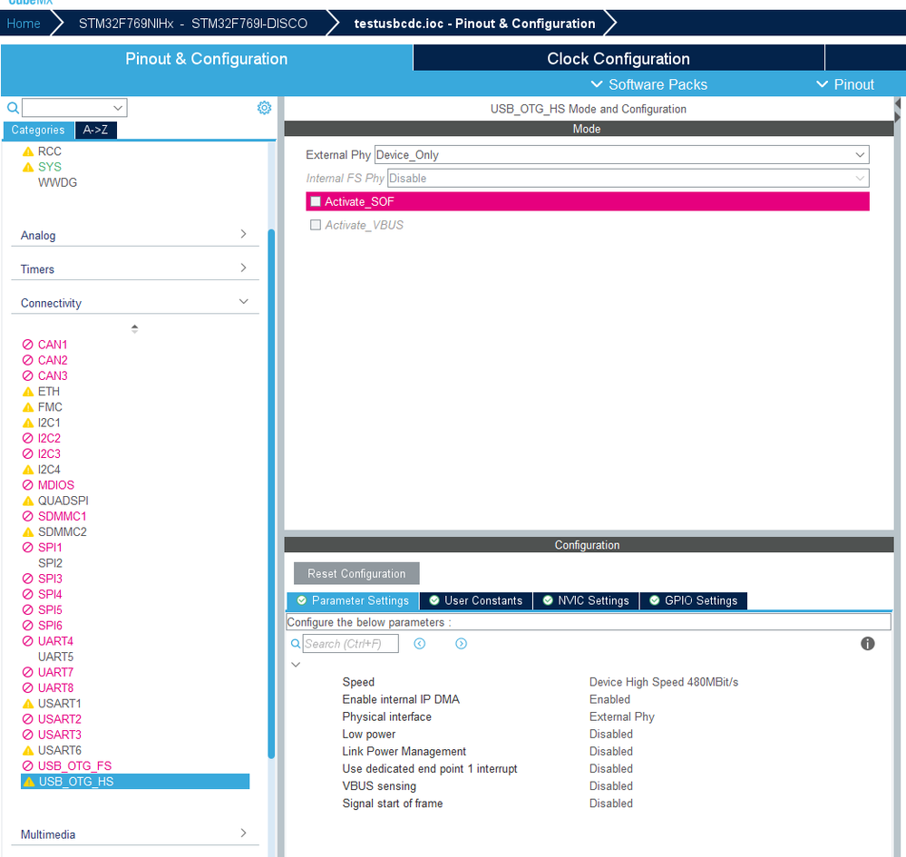

If I set Enable internal IP DMA for USB_OTG_HS to disabled it works without stopping.
