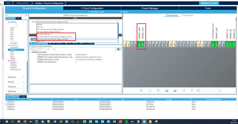

Hello Community,
I use the STM32L4R9ZITx and would like to save data on a MicroSD card via SDMMC1. Usually I use the SD 4 bit wide bus mode. After an update of CubeMX and the HAL layers now two more options are offered. One is "Auto Dir Voltage Converter", which occupies another pin (SDMMC1_CDIR) and the other is "Dir Voltage Converter", which selects an other pin (CKIN) in addition to CDIR. Since the identifiers are unknown to me and until now the pure 4 bit mode worked, I wanted to know what these two options are used for? Googling the identifiers was not very informative. I look forward to more information.
