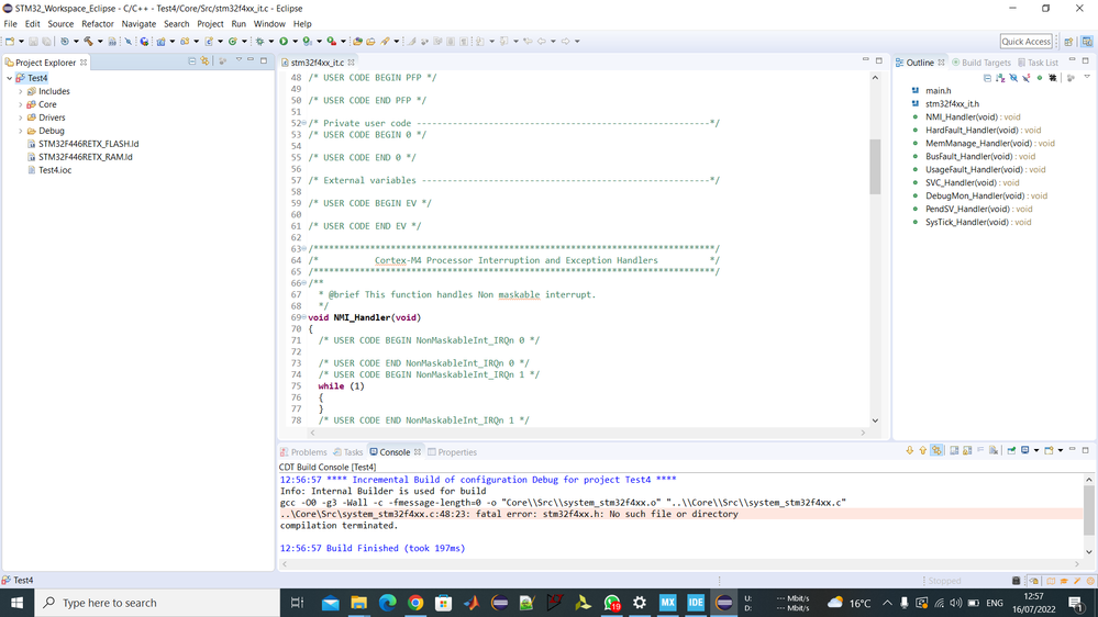

Problem finding updates and generate code. 'Problem during the server connexion'

Hello @AAli.2​ ,
Do you have still this problem to solve?
Could you update the CubeMX version? If possible share your screenshot.

Hello @Imen DAHMEN​,
Thank you for your reply. I am able to solve the problem by downloading the latest version of CubeMX. But when I generate code for a project and import that in STM32 Work Bench it doesnot work and gives me a error. I have set the MinGW GGC tool chain as well. The error I get is shown in the screen shot.
Please let me know how I can resolve the issue.
