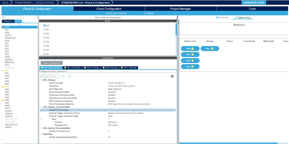

PollForConversion function is supposed to convert analog values. But, after conversion I get only few values i.e maximum minimum and mid values. Could anyone help me in this regard.

Hello @RPOOJ
Thanks for the feedback.
I test it with using STM32F401RETx then i had no problem.
How to reproduce:
- Open CubeMX the select board :STM32F401RETx
- Select ADC: IN0 ==> * Go to Parameter Setting: Enable Continuous Conversion Mode, *Go to Rank: Sampling Time: 480 Cycles
- Activate RCC==> High Speed Clock (HSE): Crystal/Ceramic Resonator
- Generate code

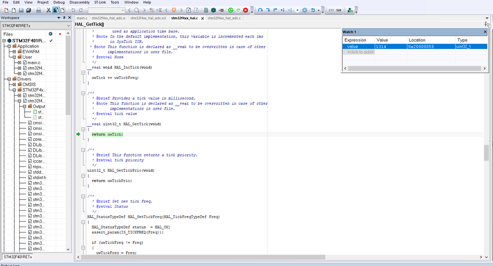

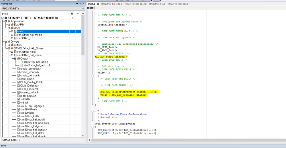

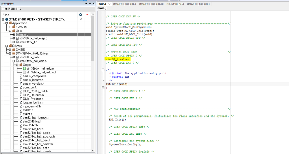

- In the main.c file : create a variable to store values from ADC
- Start ADC
- Compile
- Download and debug
