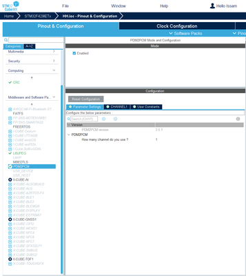

Hi tech team,
I am in search of pdm2pcm lib as per an5027.in cubemx it is grey_out. Unable to install.how to install ?

Hello @Alex_reynold
You should activate the CRC to be able to use the PDM2PCM.
Best Regards.
