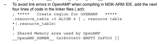

I'm using STM32H747xi with cubemx and keil. In openamp, I add below these;
0693W00000FCgbSQAT.pngin project file / stm32h747xx_sram1_CM7 and stm32h747xx_sram1_CM4. These have .scf .
I have still error. Anyone know that about this solution.
