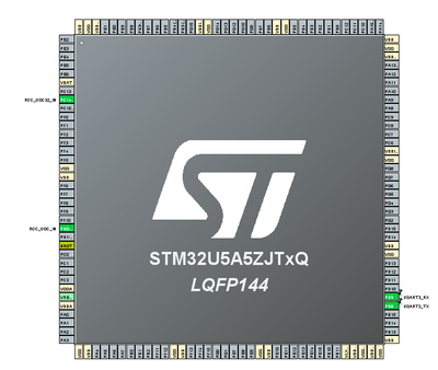

  2. Putting PD9 and PD8 on the USART3_RX and USART3_TX respectively
  3. Using the connectivity to USART3 in mode Asynchronous and Hardware Flow Control disable

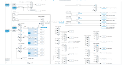

  5. Clock Configuration:
