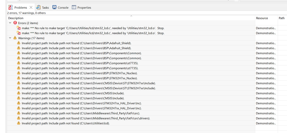

I'm trying to use STM32CubeIDE to create a project for this board from the list of "Examples Selector". I picked "Demonstrations" as seen in the picture. I don't see a ".ioc" file and when I try to build I get these errors:
Description Resource Path Location Type
make: *** No rule to make target 'C:/Users/myUserName/STM32W/Demonstrations/STM32CubeIDE/Utilities/lcd/stm32_lcd.c', needed by 'Utilities/stm32_lcd.o'. Stop. Demonstrations_CM4 C/C++ Problem
make: *** No rule to make target 'C:/Users/myUserName/STM32W/Demonstrations/STM32CubeIDE/Utilities/lcd/stm32_lcd.c', needed by 'Utilities/stm32_lcd.o'. Stop. Demonstrations_CM7 C/C++ Problem
I tried 3 different projects and all 3 don't have the ".ioc" file. That's the file that shows the visual configurator pinout among other things. In a effort to find out more I picked a different board (NUCLEO-L476RG, example "GPO"). This time I get an ".ioc" file and the project builds without errors.

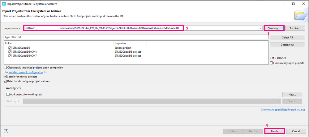

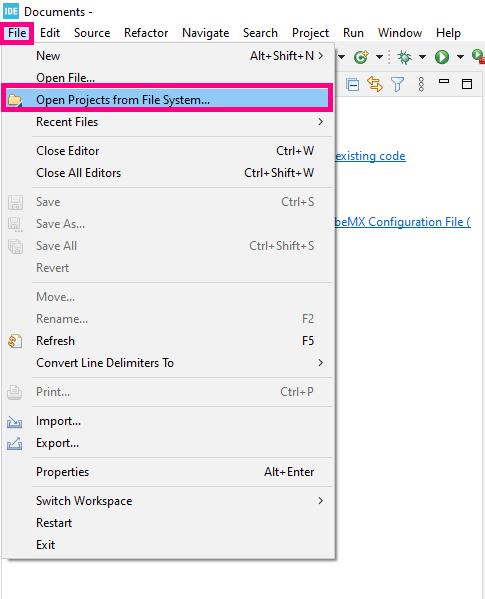

Hello @Rodo​ ,
To import the project in STM32CubeIDE1.12.0 version, I recommend you to follow these steps:
1- Open STM32CubeIDE1.12.0 version
2- Click File-->Open Projects from File System as shown in the below figure
_legacyfs_online_stmicro_images_0693W00000bkHm7QAE.png3- Browse the Demonstrations\STM32CubeIDE project file located in this path "STM32Cube_FW_H7_V1.11.0\Projects\NUCLEO-H745ZI-Q\Demonstrations\STM32CubeIDE" as shown in the below figure

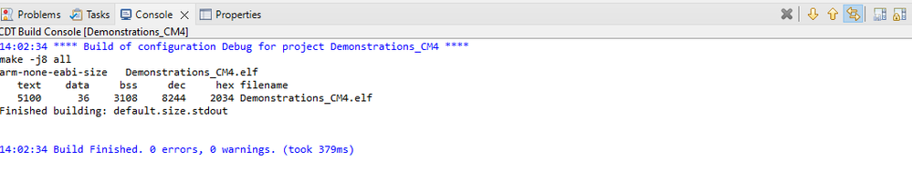

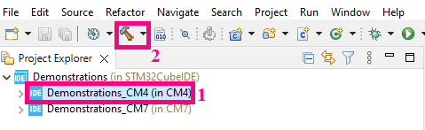

_legacyfs_online_stmicro_images_0693W00000bkHoXQAU.png4-Build the Demonstrations_CM4 project as shown in the below figure

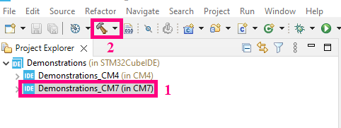

_legacyfs_online_stmicro_images_0693W00000bkHp1QAE.png5-Build the Demonstrations_CM7 project
_legacyfs_online_stmicro_images_0693W00000bkHpVQAU.pngI hope this help you!

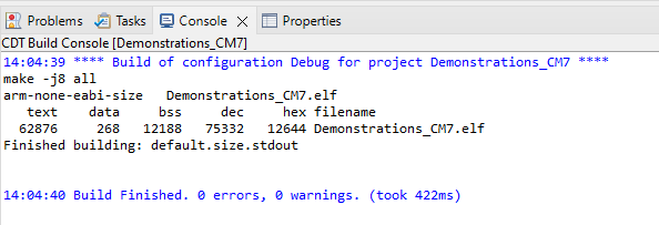

I have STM32CubeIDE 1.12.0. I'm new to STM so I just installed it about a month ago. I don't know how to check "STM32Cube_FW_H7_V1.11.0 firmware". The picture I posted shows this version. I had a friend check this demo using his Linux machine and got the same error as me. There was no ioc file and he got the two make errors I showed in my post. I don't have the default workspace folder name though I changed it to "STM32W" maybe that makes a difference?

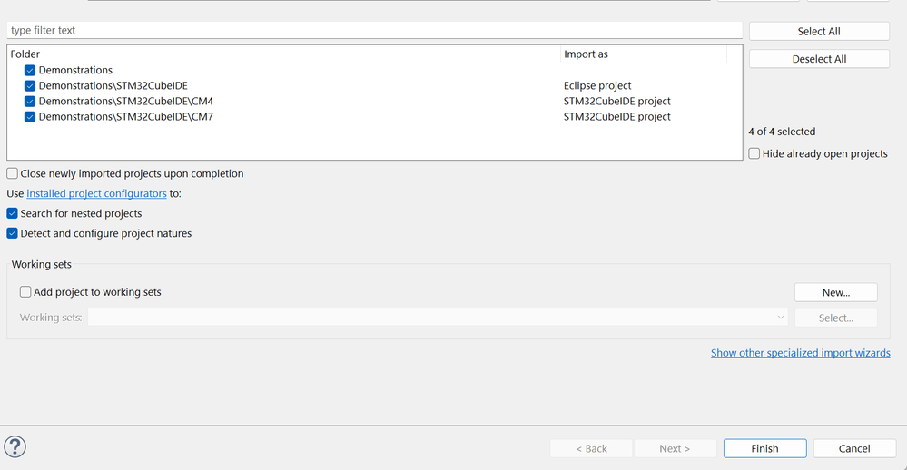

How about instructions how to import this into cubeIDE? I tried to "import project" from the information center screen but what I got didn't work. Thanks:
Hello @Rodo​ ,
Kaouthar
Ok that built without errors. Thanks. Before I mark it as answered, one last thing ... there is still no ioc (visual configuration) file in the project. How do I get that? Thanks
