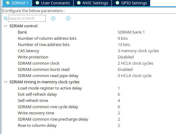

I've migrated to a new custom board, which uses a STM32F746IE and a new SDRAM model, NDS36PT5-20ET by Insignis. And although I could make a MT48LC16M16A2 by Micron work in the previous board, I have no luck with the Insignis SDRAM.
The Insignis SDRAM is rated for 200 MHz. I'm using a system clock of 200 MHz, so the SDRAM is clocked at 100 MHz. Based on the timings in the datasheet, I configured CubeMX like this:
0693W000006GvOuQAK.pngEach FMC cycle is 10 ns, so I divided the datasheet time by 10 ns and rounded up. The Write recovery time would be 1 cycle, but CubeMX sets this to 2. I also chose a CL of 3, since the datasheet doesn't list any Clock cycle time for CL 2.

For either board, what could be wrong with my configuration above?

Since I still don't know how to deal with the fact that the 200 MHz SDRAM IC is only clocked at 100 MHz, I tried to double all timings and recalculate the clocks needed in CubeMX. I couldn't enter the Write recovery time value of 2, since that violates the internal working of SDRAMs, and had to enter 5 instead.
Alas, my updated values still don't work; again, the 16-bit value at address 0xc0000000 is 0x3ffe instead of 0.
Likely something else amiss.
Make sure the GPIO's are NOT using an overly aggressive slew rate.
At 100 MHz is should take fewer cycles to hit minimum timing windows.
I have no personal experience with Insignis parts, or if this is a suitable drop-in replacement.
