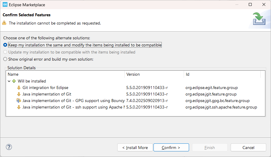

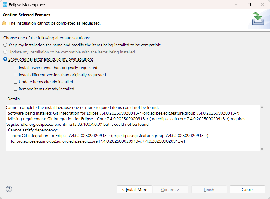

There was a warning during EGit installation:
