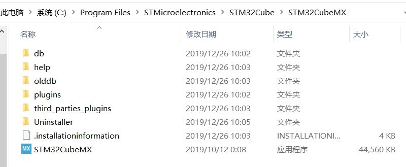

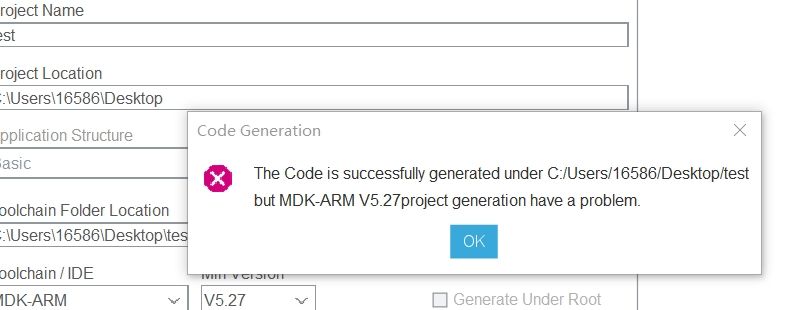

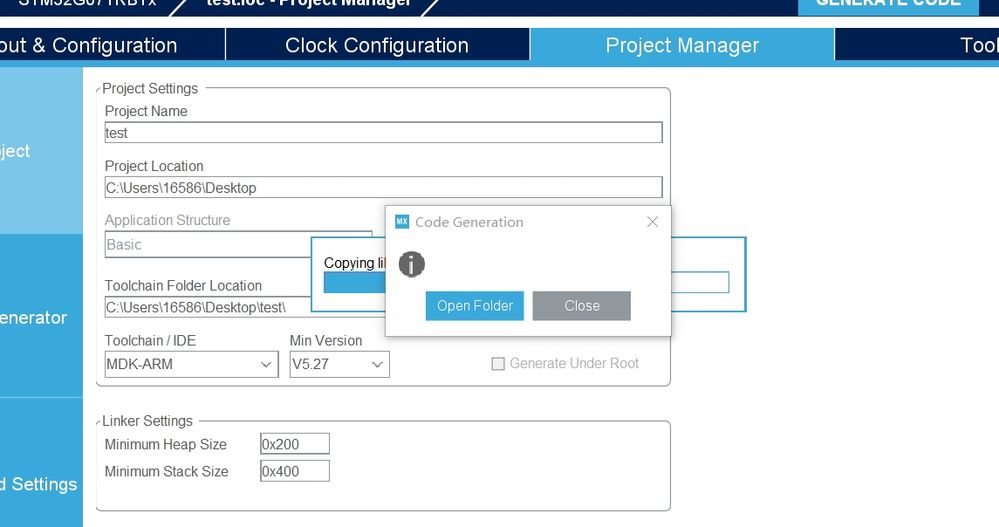

I downloaded and installed stm32cubemx version 5.4,and the default installation configuration is maintained.When I tried to generate an MDK project, I reported an error.
But it can be used normally after uninstalling and installing version 5.3.
I don't know why?I have tried to uninstall and then reinstall, or check if there is a Chinese path and other methods, which are not available for normal use.

Now it's solved. It should be a Java environment configuration problem. I need to uninstall JRE again and install it again. Sorry...

Uninstall the java program installed on the computer and install the current version again. It will be fine.
