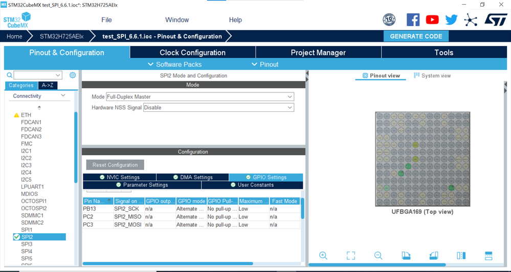

I tried to generate code with CubeMX for my project. I set up SPI2 as Full-Duplex Master without hardware NSS with the follwing pin config:

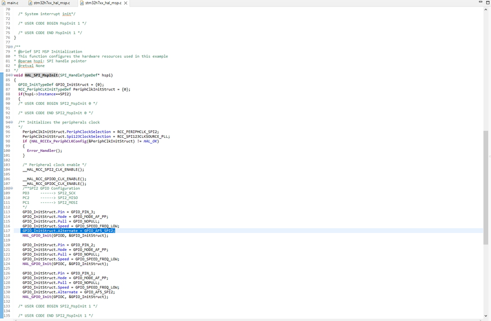

2022-09-26 8:27 AM
Hi @Florian Moser
uC: STM32H725AEIx
FW-Package: STM32Cube FW_H7 V1.10.0
CubeMX-Version: 6.6.1
I created a project where i activated the SPI2 only (same configuration as you ) to make sure of the existence of the issue that you mentioned before ; i checked the function "HAL_SPI_MspInit" and i found The configuration for `Alternate`
Kind regards
Ghofrane

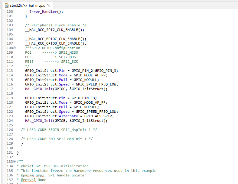

2022-09-26 10:14 PM
Thanks for your response!
It generated it for PD3 and PC1, but not for PC2 in your case.
Please try using the same GPIO as me and you will more likely run into that bug:
2022-09-27 1:25 AM
Hi @Florian Moser
I reproduced the configuration using the same GPIO as you said
I found this :
Please have a look .
Kind regards
Ghofrane
2022-09-27 1:33 AM
Thank you for reproducing!
That's exactly the bug I am describing.
For PC2 and PC3 following line is missing in the CubeMX-generated code:
GPIO_InitStruct.Alternate = GPIO_AF5_SPI2;
(Should be between lines 116 and 117 in your screenshot code)
Without that line, the MOSI pin isn't working, it just stays low.
Hope this bug get's fixed soon!
