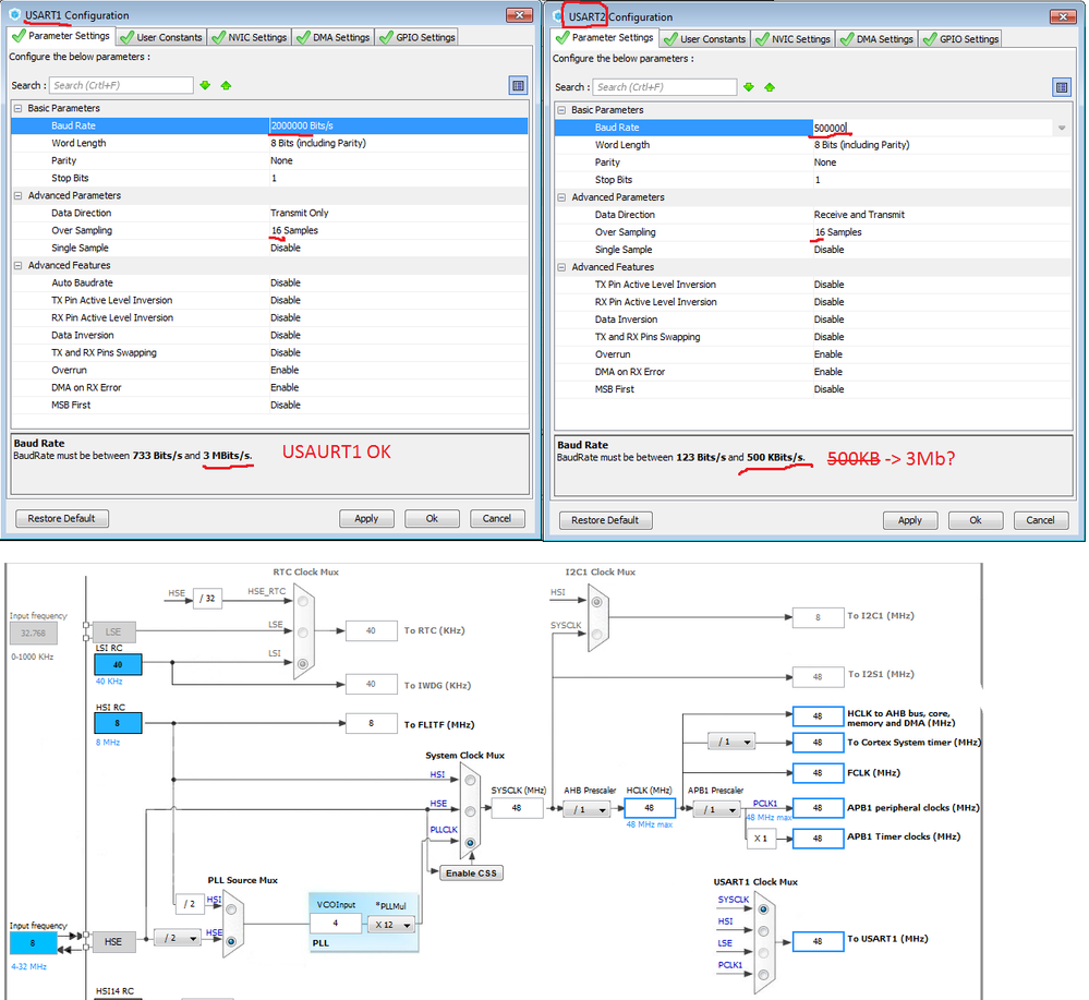

My name is Alef, I'm trying to set up the usart2 baudRate from STM32F030C8 to 2Mbps but I can not succeed.
I'm using 48MHz clock so according to the manual, at 16 samples, I should be able to reach up to 3Mbps, but CubeMx says the limit is 500kbps. But if I go in code and manually put 2000000 it seems to work normally.
My questions are:
  • I wonder if this is a Bug from CubeMx?
  • If not, why this lower limit?
  • Using USART2 with 2Mbps briefly, could it generate any problems in the future?
Thank you all.

This is an issuein CubeMX. In fact, as you said,
the maximum value of Baud Rate should be 3 MBits/s in case of 16 samples and 6 MBits/s in case of 8 samples.
It will be fixed next release.
