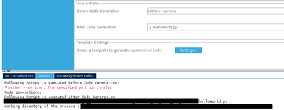

What I have to do that I can directly call some python scripts as pre/post code generation step with CubeMX 6.14.1 under Linux?
Currently I can execute directly the python script on a Windows Machine, but on the Linux machine nothing happens. On Linux I can execute the scripts directly from command line without CubeMX and I can execute the scripts over a bash script which is calling the python script.
  • Do I need to configure anything additional?
  • Is there a possibility to select which python version is used?
  • Any other hint where my problem could be?
Thanks in advance

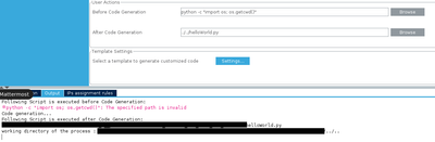

Relative path can be wrong. Try: python -c "import os; os.getcwd()"  to see if python works at all and where you are.
nobody
It looks like that it is only possible to call an existing script file. It's not possible to execute directly some command. If I understood you right, that was your suggestion.
I think it's not a "terminal window" tab. I think it's only a "file selection" tab.
If I understood you right, you also suggested to directly execute that. Unfortunately it looks that only a file selection is possible.

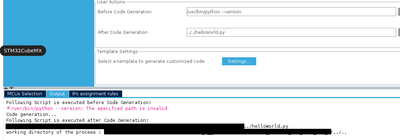

I've tried also to select an existing file, such as (in Windows) c:\tmp\junk.bat  - with same result: "the specified path is invalid".
Only if the script file is in the same directory with the .ioc , and specified *with NO path* at all  (just junk.bat) - it works.
For me, both .bat and .py files run on Windows.
In Linux, either mark the file executable or wrap in a script.
