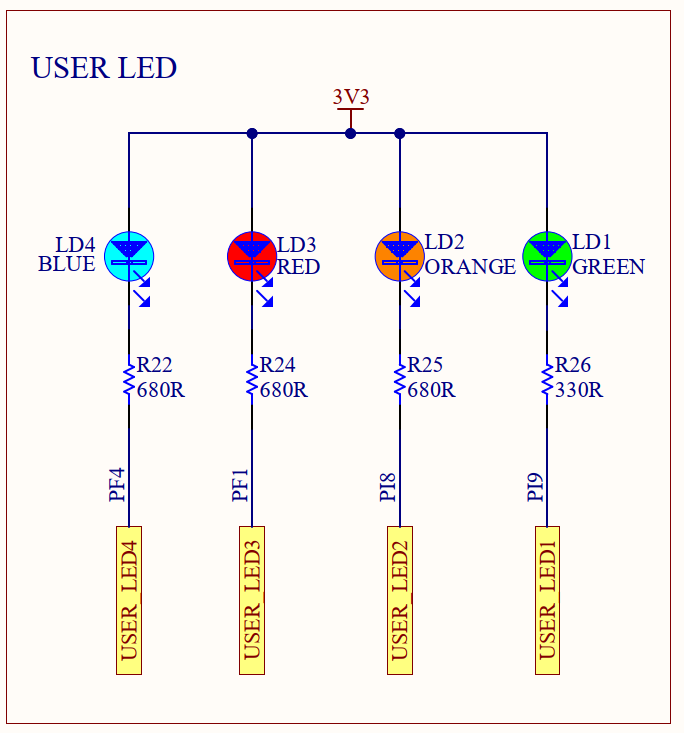

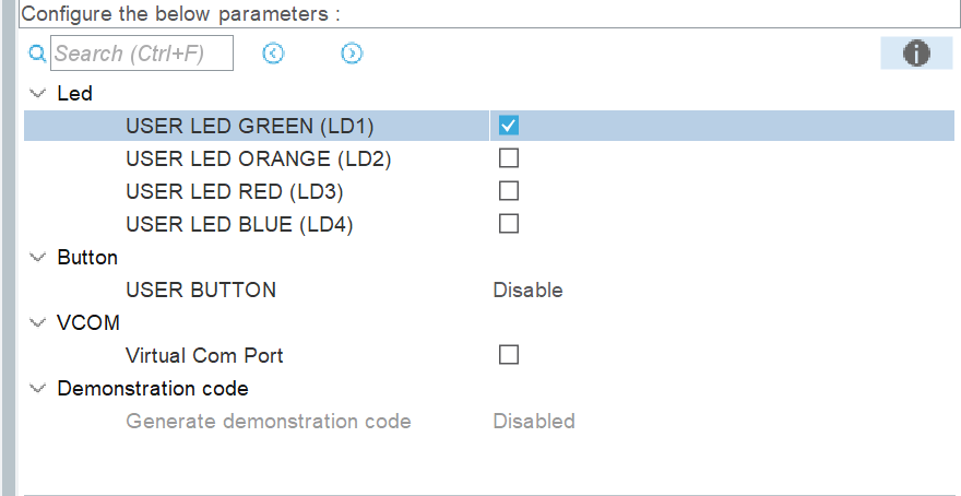

When configuring the LEDs for the STM32H573I-DK using the STM32CubeMX it generated code which initializes the LED pins as PushPull (rather than OpenDrain).
Lookign at the schematics of the STM32H573I-DK it seems to be not "the best option".
Would you agree that OpenDrain (GPIO_MODE_OUTPUT_OD) is the better option here, rather than PushPull (GPIO_MODE_OUTPUT_PP)?

Well, "perfectly fine" is not what I would call it. Because I assume that the 3V3 supply of the LEDs is (slightly) higher than what the STM32H5 drives on the PF4/PF1/PI8/PI9. So, even if LEDs are OFF, you will have a small (useless) current flow.
But if you don't care about current consumption, then, of course, you are perfectly fine ;)

Both would work.
OD is all that's needed, but push-pull would not hurt.
For clarification: The tool generates push-pull.
I am saying it should create open-drain, instead.
Moved to the CubeMX forum then.
But the generated code is perfectly fine - no problem in using push-pull.
PS:
There are cases where not all GPIOs support open-drain - so maybe it's just taking the most general case?
