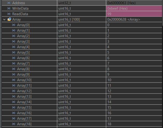

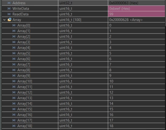

When I run this piece of code, here are the results I'm getting:
For some reason, I seem to be getting the value of "ii" in each cell of my "Array" while that's obviously what's not requested in my code. I never manage to read back the value "0xbeef". I went through the content of the functions "HAL_NOR_Program" and "HAL_NOR_Read" and they seem to be pretty consistent with what's requested in the datasheet (Table 10.17 "Command Definitions").

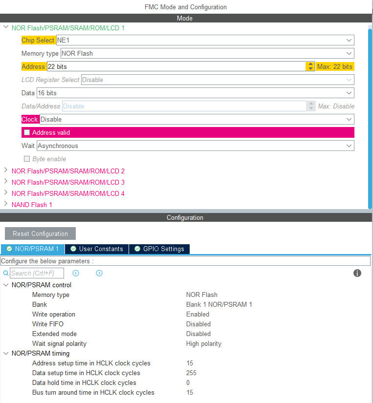

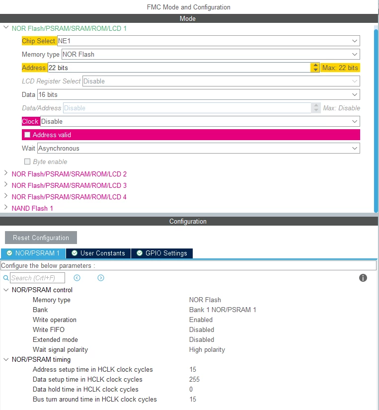

Here is a print screen of my NOR Flash configuration in STM32CubeMX:
I hope it's clear enough, don't hesitate if you need more details.
