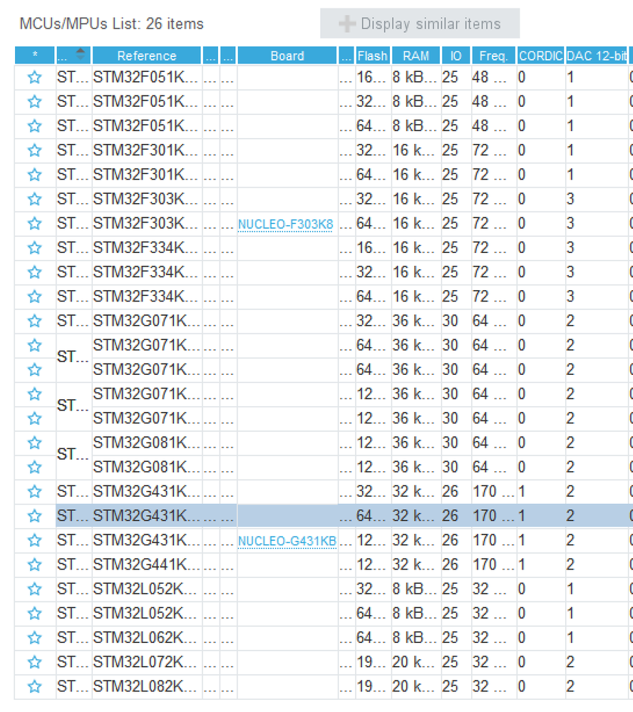

is there an STM32 with a DAC available in a 32 pin package?
deep_rune
the title says it all. Please let me know!
2 REPLIES 2
STM32CubeMX can do a part selection like this for you.
The F0, F3, G0, G4 and L0 series have chips that do this.
Uwe Bonnes
Principal III
Use the stmcufinder!
